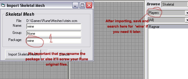

I think this way is clearer:

hey imp tried it and nothing here's my model can u try to import it maybe somethings wrong with the model itself?
Tue July 15 2003, 02:28 PM
Yup, something's wrong with it; I couldn't get it to work in Pygmalion or RuneEd.
Try using the stein I posted and see if it's diferent from the one u used.
Try to use the stein in its original state: export it from Milk without any changes and try to get it into rEd (remember to change Name & Package). Build up your model and try it in the game. If it's working go back in Milk and modify the mesh step by step. When you'll get stuck (if you do), at least you'll know why; I performed the same "ritual" in the begining lol
